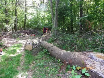

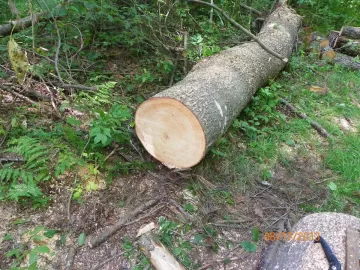

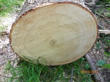

This came down in one of our earlier windstorms, I have two eight foot logs that we'll be milling tomorrow.
I c & s some of the pine for shoulder season wood, I finally did get this section of the trail opened up instead of the small path I had.
https://www.hearth.com/talk/conversations/storm-last-night.5990/
The above link is what it looked like after the storm, pic 7782 is after today.

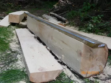

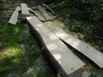

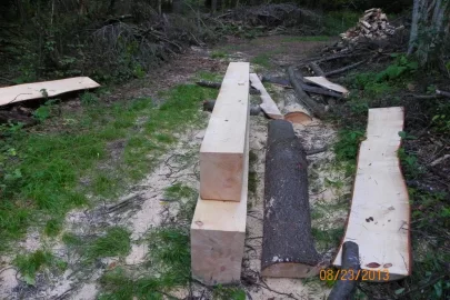

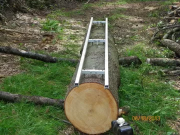

Nothing went according to the plan, the 660 flooded out after edging the first log with the mini mill. I popped the top on the second log so I can go back at it tomorrow.
On the second log I'll edge the two sides with the mini mill then start milling some boards.

This was the first time with the mini mill, I used the 660 edging two sides of the first log then ran the 075 edging the rest.
I thought the 660 did a much better job.

I like the smallest saw I can use for the mini mill. Even a 192t works at times.

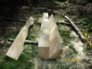

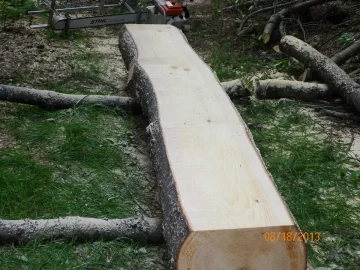

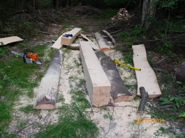

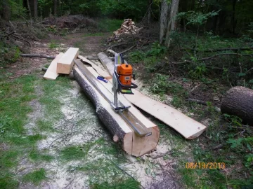

I did a quick run back in tonight so I could run the mini mill on the second log, both are all set for milling.
I did take Smokinj's suggestion of giving the saw a few breaks (about 4) on this eight foot log, the 660 never flooded tonight.
Wow, some nice, clean looking cants there, Woody!
Gonna make some nice boards.....I can smell that fresh evergreen from here!
I like the way the mini mill edges the log, can't believe this is the first year I used it. I've had it for two years.
Tomorrow I'll sharpen some milling chains (didn't like the way they looked when I grabbed one tonight) then mill up one of the logs on Wednesday.
