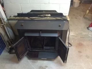

I have no idea what that stove is do you have a picture?
[Hearth.com] Long Wood Burning Stove 1662 [Hearth.com] Long Wood Burning Stove 1662 [Hearth.com] Long Wood Burning Stove 1662
Sorry that probably doesn't help much, but that all I really have except for some more pics I took of the guys manual of the clearances.
I was told it was a silent flame 1662, but I have not seen silent flame printed on anything. I have read Long Mfg made silent flame stoves.
looks kind of like a buck copy. If it is really like new the price is not bad but not great either i would hold out for something better myself
In Georgia you would probably do fine with a 2 cu ft stove. Considering one can get a new EPA insert for $1200 or less I would consider that option. Englander, Drolet, True North and Century all make medium sized inserts in that price range. For success you will need 15ft or more chimney and dry wood to burn.
