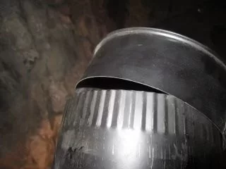

I have an Englander 30 with a 30' chimney and a SS flex liner inside my old chimney. I always thought the secondary flames were exiting way to fast, and the doghouse air sounds like a jet engine. So I did an experiment. I have a T in the chimney pipe with a cap on the end. I cracked the cap open a little at a time. And now the stove runs way longer, with great secondaries. I have a baro damper ordered.

Your going to invite cooler air into the stack, cooling the gases and create creo much faster. Keep an eye on the stack.
Is that pic upside down? The seam looks running the wrong way?

Picture isnt rotated right... I didnt think of a manual pipe damper.. that might work also
