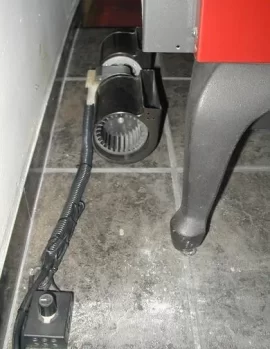

I have the Heritage with the heat shield and blower, and looking at it, once you have the rear heat shield I think you can prefab a blower to it. As said above, the heat shield just mounts on the back and the hot air that is trapped there is vented out over the top of the stove. It does keep the heat off anything that is behind the stove, and works very well.
