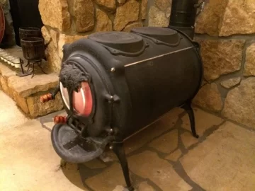

Looking at it now. So the style is called a "cigar burn" are there any other stoves in this size/shape?
Many, but none modern that I know of. I've ran a couple "pre epa" and liked them. It is a solid design but for whatever reason seems to have fallen by the wayside. Could be, they just don't fit in modern homes but for your application it just might.
Buck 261, although it may not be quite enough for 22". (21" is listed split size).
