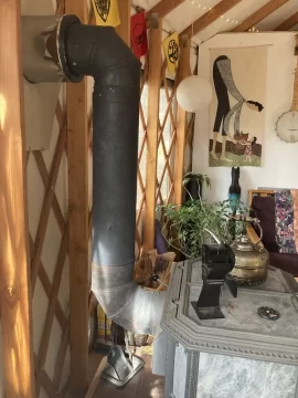

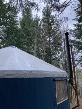

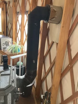

I'll attach a couple pictures, but basically, stovepipe comes out the back of the stove, 90's up, runs vertical a few feet, 90s out the wall into a T and then runs up 10 feet to cap. The two things I'm suspecting might be issues:
- Is the 10' main stack (plus the 3' of vertical single wall inside) enough height, given the two 90s and T in the system? If not, how much should I extend it?
- My interior pipes are connected a little off, such that the joints aren't totally tight since the angles aren't perfect 90s (this also causes the part of the 90 that connects to the stove to be angled slightly downhill away from the stove, and I have noticed some sooty discoloration on the outside of that 90). Wondering if I should just put furnace cement in the joints each time I put them back together after cleaning? Or worth it to reconfigure the set-up so that the angles are more perfect 90s?

As for the stove setup, it should have been directly vented straight out instead of having three 90º turns in the smoke path. This is slowing down and cooling down the flue gases which will increase creosote buildup in the cold outdoor chimney. In the least the stovepipe should be double-wall. One option would be to pull the stove further into the room and come off the flue collar with a 45º elbow pointing upward connecting to another 45 elbow at the chimney thimble. Doing this will elimate one 90º turn. This should be done in double-wall stovepipe.
What is being used for chimney pipe? It usually isn't black. Is this stainless class A pipe that has been painted? Is the current stovepipe at least 18" away from any wood?

I know it would have been better to send it straight out the wall and avoid the two 90s, but I already had the hole in the wall up higher from our previous stove (that proved to be too small) and didn’t want to reconfigure the whole thing and cut another hole in the wall. The black pipe inside the yurt is single wall stovepipe. Outside I have double wall stainless pipe that was painted black. Are you saying using double wall for the interior run will help with the creosote build up and/or the draft?
I don’t think I have enough room to get away with the double 45 move. I’d have to move to stove too far forward.
Would adding another 18” or even 3’ to the exterior stack help?
thanks,
Looks like you may need to do what my neighbor did on an OWB. His stack was too low and was skunking out the neighborhood. He tried adding length unsupported but it still was no tall enough. He ended up installing a steel flagpole next to his stack and supporting the stack off the flagpole. He still has issues on occasion but mostly on days when its cloudy with low clouds.

If the joint coming out of the stove is angled down then you need to fix this ASAP. In fact the pipe should angle up if at all. Correcting that issue will help with smoke spilling. If you are committed to keeping the class A as is then maybe double wall inside will help. If you are spending money I would just make the stove connect directly to the class A out the back, but that would really limit stove options in the future.
