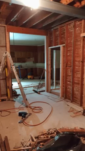

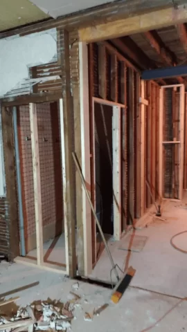

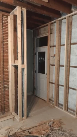

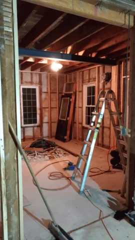

Hi, Here are some pictures of the room. in the one you can see where the old stove pipe comes through the wall (its being moved down to meet code). Another shows the opening towards the kitchen, and the other shows the other end of the room where the stairwell is around the corner leading upstairs. I added one more to show the bottom of stairwell.

Great, that's quite a project. It looks like 10' ceilings, is that correct? Unless you are super-insulating the place I think a larger stove will work. I had a small concern that the stairwell would be large and close to the stove which might allow too much heat would convect up there, but that doesn't look to be the case. Is the stairwell at one end of the house instead of central? What insulation level are you putting in for walls and attic?
there is a new ceiling going in so they will be about 9 feet. There will be spray foam in all walls. The exterior walls are double brick already and then there will be R19 spray foam on them. Attic will be R60 blow in upstairs. Yes the stairwell is at one end, rather than in the middle of the house.
