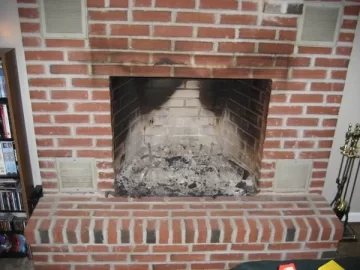

I am looking for an insert for a heatform fireplace. House was built in 1987 and I have attached a pic of the fireplace I want to add an insert too. Any suggestions on what to buy or what will fit? Also what will I need to do to have an insert put in such as Hearth extension or flue/damper changes? The size of my fire box is 33” wide, 28” high, and 24” deep from the center of the front to the back wall. The width of the back of the firebox is 22". The walls slope in pretty good from front to back. Hearth size is 12". Thanks for ideas and or input! I am a newbie with this stuff so take it easy on me!

You can search the various manufacturers of wood burning inserts & most of them will have t
an insert sizing guide to help you decide which models will fit.
You're definitely going to have to disable or remove your damper,
& you're definitely gonna need a hearth extension...
A flat front insert like my Vista will need less of an extension than one that sticks out of the fireplace.

US, to the right of the FP, is there a wall? It looks like it in the pic. If so, clearances could be an issue.
And yes, you will need to build out your hearth area.

Thanks for the info guys. I am really looking for the easiest way to go without having to do a ton of midifcations. I am considering the Quadra-Fire 2700i. Any input on this or models like it that I should look at?

You'll either need to extend the hearth out or find a stove that fits back enough into the fireplace to give you the specified setback, probably about 18".
US, depending upon your final decision, the sides & top will probably be ok. There will be clearances listed in the manuals of the inserts you look at.
How raised is the hearth (height) ? You'll want to protect the rug no matter what the outcome.
While you are checking out inserts, you need to know the square footage of the home you are heating and go with an insert that can handle alittle bit more square feet. That'd probaly help you get more input as well. And a p[ic of a floor plan, if you have one or can make one.
