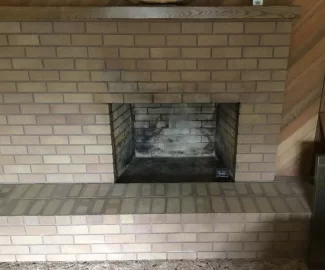

I have been reading about stoves here a for awhile, now it’s time to see if I have learned anything. I am looking for a wood burning fireplace insert.
The house is 1350 sq ft ranch, good insulation and windows. Existing masonry fireplace in the 280 sq ft living room with a large picture window, eight foot ceilings, connected to kitchen and bedrooms with hallway. Currently have a heat pump, looking at the insert for supplemental heating and enjoyment of the fire. Fifteen foot tall chimney, ten inch diameter tile liner. Fireplace has air vent in bottom, when I open the damper, the spider webs shake and there is a good draft.
Fireplace dimensions-
36” wide, 24” high, 23” deep
21” from top of fireplace to mantel
Hearth width 16”, 14” above carpeted floor
Clearances to combustibles are good
