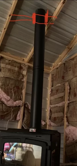

Hi,
I want to install my stovepipe and Class A chimney without the box for cathedral ceiling. Is there some type of simple minimalist bracket that can attach to the rafters and then to the pipe to secure it?
Imagine some type of ring clamp affixed to the pipe and then the ring clamp with me attached to the rafters by some type of leader.

Not that I know of. Some manufacturers offer a bracket that mounts to the roof. But you would then need custom trim to cover the gap around the chimney. Plus you would have chimney exposed in the house.

Are you insulating the roof at all? You would need a box of some kind to keep the insulation away from the pipe.
What is your vision for how the finished installation would look?
Those rafters are 24” apart.
The section with the pipe/chimney will not have any insulation. The other sections will.
This season’s (and at the most next season) aesthetics don’t matter as the cabin is a shell at the moment and the roof will be removed and converted to a flat roof.
Where did you find this? Got a link?
You need to use the part made by the manufacturer of your chimney pipe. What chimney are you using?
I don't understand why you don't just want to use a support box it is the easiest option by far
