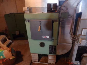

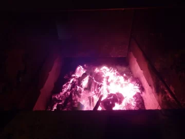

I had the Ardent f75 installed about a month ago. The coldest weather we have had so far this season is -10. The furnace is doing the job with ease. I load this furnace around 6:30 am, and return to a nice coal bed around 5:30 in the evening during the work week. On colder days I load the firebox a bit more and weekends burn more wood as we are home more. I like it, and very happy we purchased it. The furnace was out 2 time for cleaning since we installed it. One complaint is lighting it, the fire box is below the furnace door and it drafts from the side so it can be a bugger at times. 9/10 overall. Thanks hobbyheater for fielding my questions.
Some picture below
