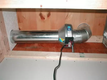

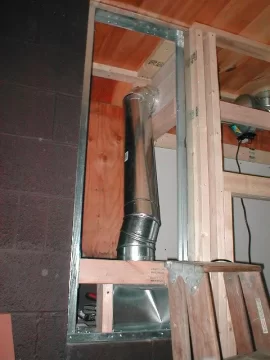

If you have access to your attic, I just did this.........................
And it pushes a lot of air from one room to another, need a good fan, and I used galv. duct & wrapped it in R-6 duct insulation.
You can also go through a closet or such and do this set up through the walls. I do have fire dampers being delivered to install in this system.
Before going nuts, I would run the stove for a season at least, get used to the stove and fine tune your burning with that stove. Then if you still need heat in another area, then make some decisions.
I am going from office to connected bedroom. So not a big stretch.
