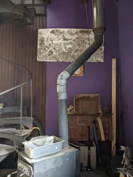

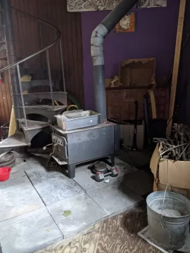

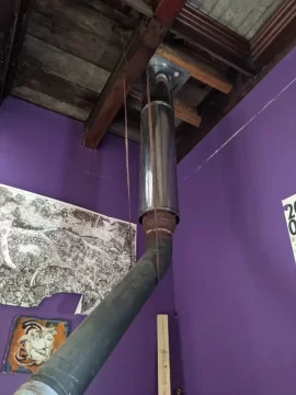

Not sure if there was something specifically people wanted to see, but here are some pics of the stove and chimney. It's a pain to get on the roof, but can if necessary.
Also including a pic to show the kind of clearance we have. The buckets of kindling and other junk laying around will move when we actually start burning wood, we just were moving some things around in the summer. Stove can be moved forward when we get a new one to create more clearance.
Also we do usually use the plastic window material every season which I forgot to mention.
As far as value on a replacement wood stove goes, would I be overpaying at 750 for a fisher or equivalent large stove?
To the fellow ma person, I'm not too far from you. If people are unsure or think it's necessary that someone see it in person, I may take you up on your very kind offer to come look at it.
PXL_20211011_163057410.jpg PXL_20211011_163109789.MP.jpg PXL_20211011_163242476.jpg

I'd be looking at a $998 Englander 32NC to replace that stove. You will start using less wood immediately as long as the firewood is well seasoned. That will start paying back for the cost of the stove with every fire.
Tthe galvanized piping in the stove pipe must be replaced and perhaps replace the rusted increaser at the top too. Galvanized duct pipe is not suitable or allowable for use as stove pipe.

Oh, and I should have responded asking about the piping. So the galvanized piping, is that all of the piping leading to the increaser or just the lighter colored material at the elbow? What kind of piping should I be replacing it with?
The galvanized section is the two elbows in the middle. Also, I can't be sure from the picture, but it looks like the stove pipe is installed backwards. All the crimped ends of the stovepipe should point to the stove.
