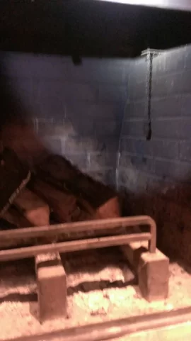

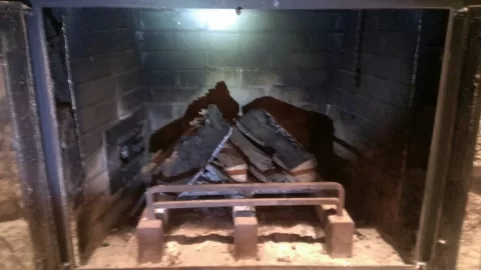

[Hearth.com] Looking for some guidance on a wood FP to pellet insert upgrade...

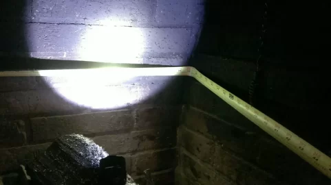

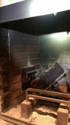

It has what I believe is called ventilator set up that exhausts out the bottom right and left side of the step up on the rock mason work through two 2 " round pipes
Internal Left Side, fresh combustion air door.
Internal Right with chain for damper control at the top of the chimney, top hat type ??

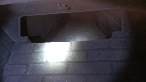

I believe maybe at one time it had a solid damper at the bottom area ?? Looking up flue here.

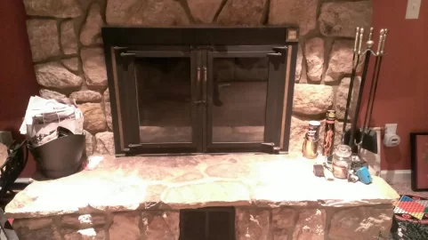

Back wall measures @ 29" wide
Front rough opening is about 36"W x 29/30" H with about a 26" depth

Hi Steve and welcome !
You absolutely can heat your 1800 sq ft. house better with just about any stove than the fireplace would even begin to do. Your experience is familiar sounding, though our fireplace had no glass. But ya you can literally feel the air rushing to an open fire. That said , we opted to put a stove on the hearth vs an insert in the fireplace but there are many people here at the forum using inserts. How well a pellet stove/insert heats evenly has a lot to do with house layout. For instance , we have an off shoot or extension that is cool compared with the rest of the house but our house is old and much looser than modern construction would dictate. Non the less, 1800 sq ft, we heat right down to about 4 deg F. At that point and lower I opt to supplement with the oil burner.
The fireplace sucks a ton of air. A pellet stove without an out side air kit ( OAK) can draw some air as well but you will get a lot of heat output into the house mostly by convection blower. A pellet stove ( we will just identify pellets inserts as pellet stove from this point on) with an OAK is now drawing outside air in for combustion and that ends the draft cycle that runs to the stove that is run up the chimney otherwise. The key there is combustion air. Convection air will circulate with some natural layering . Cool air low near the floor and warm air higher. That warm air is blowing away from the stove, the cool air will try to return to the stove. This is not to be confused with combustion air that must be replace by ultra cold outdoor air. The natural occurrence is tame in comparison.
Several good inserts out there. Most web sites rate their stove for a range of Sq ft the stove will cover. I would look at Harman, Quadrafire and Enviro first and in that order. That's my personal preference, others might reverse the order! These are the popular higher quality stoves out there to give you three names. Breckwell makes a good insert too.
Could you give us an idea about house design, style and or layout ? This so we could best guide you.
There are a couple of ways to go on an install. Most popular in an insert like you want to do is to run a 4" liner up your chimney to the top and draw your combustion air down the chimney. This keeps it all neat with in the fireplace and best utilizes your existing fireplace and chimney.

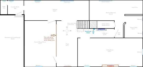

Thanks AH for the reply, yeah I think for the WAF I'll be looking into the inserts rather then a freestanding on the hearth so long as I'm not too restricted with a super small hopper on an insert (have to start shopping) so just a 4" liner typically is needed for exhaust flue on most huh, that will not be a problem to run , I have a 10" or 12" SS liner to utilize...I guess the existing cold air intake slider door down in the firebox wont be needed or better to use that as well ?

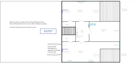

I will sketch up a basic floor plan of my home and upload as well, but its a 2 story in which the 2nd floor is a dormer with 1 bdrm toward the front of the house and 1 bdrm toward the rear with a full bath in the center.I just finished adding a separate modern 2 ton HVAC system (heat pump) for upstairs because the home was originally built utilizing the 1 older still existing unit downstairs for the entire house (which didn't work out at all) will be upgrading the Heat Pump and duct work for the 1st floor eventually as well but the pellet insert is 1st.

Get your floor plan and some more details posted for helpers here to critique and offer guidance and suggestions for best results. Good Luck! Welcome!
I was wondering if that was a fresh air hatch or clean out what ever, that ran outside. Yes you can use that to access fresh air. You would do a fresh air line etc.. Actually ask F4jock, I think he did something similar in his fireplace install.

I was wondering if that was ah air hatch or clean out what ever, that ran outside. Yes you can use that to access fresh air. You would do a fresh air line etc.. Actually ask F4jock, I think he did something similar in his fireplace install.
Yeah. Was simple. Ran 4" SS vent pipe to top of chimney and capped it with a proper baffle. Sealed off the chimney to fireplace cabitu w damper and thick insulation. Sealed around the insert bezel to stone and stove and opened the cleanout door. Hung a ribbon in the door to monitor airflow. Sucks it almost horizontal.
There are both actually in there, fresh air intake on the left side wall and on the floor in the back center there is a clean out hatch but when they installed the ventilator set up (at whatever time?) they kind of obstructed the access hatch to be user friendly with the square stock ventilator tubing (poor design or install ?)

My guess is that you will have reasonably good air flow to 2nd floor if bedroom / bath doors are left open there. My larger concern is with main floor air flow. Openeing out of LR is not large, with hard right angle to MBR are main concerns, but all homes have challenges. If you like a cool bedroom, should be good.

Thanks Wilbur, I'm assuming if I run my HVAC air handler fan on low which the return vent for the system is right in the hall outside the LR that should also help with circulation of heat throughout the house in the troublesome areas, the entrance to the LR is a 4 ft opening ?
I think for looks mainly the insert is the way to go for me in this room, the hearth is raised by 12" off the floor already and only 21" deep from the front of the fire place so I don't think a freestanding unit will look nearly as good, plus when I discussed the insert option with the wife and she noticed the insert protrudes 6-8" out onto the hearth as it is from the glass front we have now she wasn't to thrilled about that even(she likes to be able to put things there or sit there and have the room....not a complete loss, I have a sun-room /family room eventually getting built off the kitchen that will need heat and will most likely get a freestanding unit for there :)

4 ft opening to Lr is good (but not as good as 6 or 8!). It's all about air flow and letting that heat escape to other rooms. Air handler help will depend on how well ducts are sealed and insulated, and how much they run through unconditioned space. If all good it will help wuite a bit. If not, very little.
