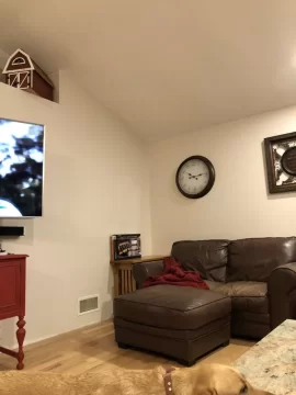

Hello All,
I am looking to install a wood burning stove or zero clearance fireplace in this corner in the photo. In my last house I had a Regency Warm Hearth zero clearance and loved it.
Looking at the corner, would I be better off doing a stove or ZC? This is the main floor of a 1550 sq foot one story home, the basement is half finished, approximately another 900 sq ft. The corner is not an outside wall. On the other side of the left wall is my laundry room and the right wall is my gas furnace heated garage.
If I did a stove, I would probably move the cold air return by the floor, up to the ceiling. If I did a ZC, I would probably duct it into the furnace duct work to spread the heat.
I work from home and will be burning most of the time, but we have a natural gas furnace as well. I feel as though I do not want a catalytic stove because of the added cost/maintenance and I have all the free wood I can burn. I do have 3 kids at home, the youngest is 5 years old.
The models I am currently debating are a Regency F3100/Pacific Energy Summit or a Regency R90/Pacific Energy FP30.
The Regency R90 is closest to the Warm Hearth that I loved, but I am not crazy about the double doors.
Does anyone see advantages/disadvantages to either route?
Thanks

Id go with the stove every time unless heat output means nothing to you. Return ducts have to be minimum 10 feet from the stove I believe.
Reactions: ratsrepus
A corner install eats up more space than a install along the wall.
Our thought was that the zero clearance unit would be safer with the kids and dogs. Does anyone have any thoughts on that? Thanks

The corner looks like a nice place for a stove and I’ve always liked the look but they do take up more room. How far away is the door to outside for bringing in wood? The best part about a free standing stove is the ability to replace it or exchange it for another stove very easily, wether something goes wrong with the old one or simply to upgrade.
