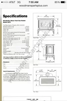

I do have the spec sheet for this stove that has some additional info.

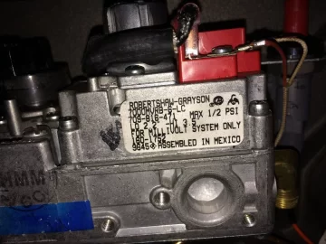

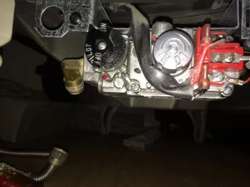

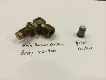

Here's a picture of my regulator, pilot and burner orifice,and the spec sheet to my stove.

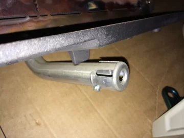

Also a picture of the tube that fit up to the burner injector that has an adjustable part I'm guessing for air flow. Would that be where you adjust how your flame burns/looks?
Not smoking or not lifting off the burner and the proper color.
I didn't see anywhere else that looked like a place where some sort of air baffle would be installed. I read in the owners manual for a Reliance model 2600 (which used the same conversation kit), where you add a baffle to the flue/chimney if you were venting straight up through the ceiling over a certain number of feet. Perhaps this is the baffle included in the kit. I'm using the same vent that was used before.

the regulator is easy enough, as is the pilot orifice- a good local hearth shop should be able to round them up for you.
the MB orifice is another story, no idea where you'd get one of those!

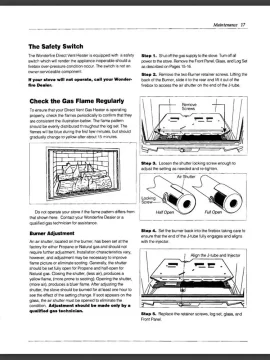

The main orifice I got from ignus.co.uk they call it a "jet brey 82/300" listed under "injectors". I tried to use the checkout and got a message "we don't ship to your area". I emailed them and they happily sent it to me with my credit card payment. It was about $15. I got the pilot orifice and had the regulator converted at a propane stove shop not far from me for about $40. The only other thing I had to do was adjust the air shutter to full open I read that in the users manual that I located and will try to attach to this.
You can find the users manual on this site. Search " Wonderfire 2570 gas stove" . It is a pdf.
