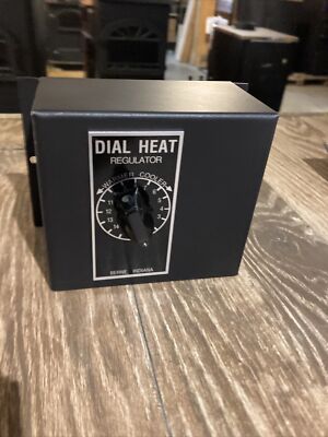

Maybe a bimetal spring regulator...these are used on quite a few different stoves out there...here is one that was retrofitted.
I know that some Amish use these regulators to operate PSG Caddy wood furnaces without electric...supposedly works pretty well, as long as the house can be heated with gravity heat. (no electric, so no duct blower)
