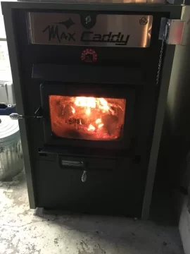

Depends what your climate and other goals are . I have a max caddy . It's a high tech EPA unit and has a very large firebox for long clean burns and more heating capability .mine has been wonderful and a joy to own and I wouldn't trade it for any furnace on the market and I have owned several other units over the years . I heat a 2,000 sq foot split level in northern pa. Love the giant viewing window the quality construction the auto air setting and variable fan speed control. It allows for ability to run an electric heating unit option domestic hot water option and fuel oil burner options .technology with versatility ...In my opinion bigger is better and this one really stands out in the pack of new EPA units ,mine has proved to be a great investment for me

I load and go on a bed of coals but I burn very seasoned wood and I sweep a couple times a year to ensure everything is good to go .a fresh recharge and You may need to open the load door a while till it takes off good but don't think you have to baby sit the thing just because it's not a 6,000$ kumma lol it runs off your digital thermostat and does several things the kumma can't do but I won't get into a peeing match over which is better ..the max caddy also has a large high tech firebox that offers burn times over 12 hours and can heat over 3,000 sq ft . it is Very simple to operate and you set the t stat and let it do its thing it even changes the blower speeds according to duct temperature . Seeing the fire in the large viewing window is a great benefit to me
