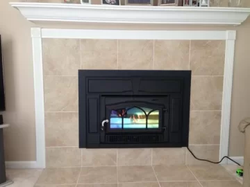

I recently put a Jotul 350 in my superior zc br42. The stove is a tight fit and I had to use an offset box. I am not sure if the stove can be removed without pulling up the liner. When I watched them install it, it appears they attached the box to the liner, pushed the stove in, and then dropped down the liner setting the box into the stove.
The stove looks awesome, burns well, puts off only a little heat, and my zc has so many vents that it drafts like crazy nearly offsetting any heat production. I just stuffed roxul around the liner and that helped some. I think all of the louvers and vents in the zc pull a lot of air when the stove is burning.

Here is what it looks like.

We often see XC boxes pumping cold air out because the unit didn't get insulated behind it during construction. It's a very common mistake. \
That insert, with dry wood should be pumping heat!
This looks like a tiny opening.The photo makes it look like the front opening is only 15" high. Can you measure and post the actual H&W of the fireplace opening and the depth top and bottom to the back and the rear H&W?
Wow, that looks beautiful!
