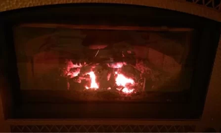

Hello,
I've read and agree with the notion that since this is my first year with this inset and with a cat unit for that matter - that I won't know what is a good burn time. The manual says I can get "up to" 12 hours of burn out of my 3.0 cu ft insert, fireplaceX large flush arch. On overnight burns I load it full and when I wake up I do get hot coals after about 8 hours.
So what I'm looking for is some general burn tips:
1. When should I reload and how. Right now the blower is still blowing hot air, and the coals are big and white hot - not powerdy yet. Should I reload right now- a single piece or jam it full? I think the right thing to do is jam it full, open up the air so the wood is engulfed and then over the course of 20 minutes or so choke the air down almost all the way. If I totally choke the air I get a lot of carbon on the glass. I have it about 1/4" out from choked out usually. But should I let it just go on coals until they are nearly burned out and the blower turns off? Try to reload like 2-3 times a day? Right now it seems like I'm reloading 6 times a day.....

Your wood usage doesn't seem excessive.
On non-cats, I usually run it down to small coals, then stuff it full! If the Stove is hot, I'll turn the air all the way off to achieve good all night burns. The glass will get dirty, but an extra few hours of burn time is worth it. 12 just won't happen, that's marketing bullcrap. You might be able to scrape up a few sparks after 12 hours, but it won't be making any heat.
1. You are still just maybe 2/3 through your burn cycle. Those coals will throw heat for several hours more. No need to reload yet. When coals are much lower, rake them forward, drop splits behind and on top until you almost hit the baffle. Let the wood catch fire with the door open, close it, let fire establish itself and then reduce air in stages. Once cat reaches temp, engage that one.
2. Filling the firebox as much as possible will extend burn times. Having longer splits or some very short ones to fill the sides will be helpful.
3. 2/3 of a cord per month with a 3 cu ft insert is really not that much when burning 24/7.
