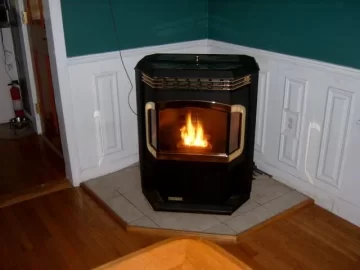

All stoves and Harman is no Exception will get soot on the glass when it is burning, and the more glass generally the more soot because there is not enough airwash to keep it clean. Attached is a pic of my Advance from last year note the soot starting to accumulate on the left pane and the left center pane of glass. This is 2 days after cleaning the glass, after about a week it starts to turn black.
Not trying to freak you out or anything but lots of people aren't told that the glass gets dirty when they buy them, just a heads up..
