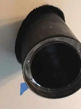

Yes, that’s correct. You can see the collar inbetween the stove pipe in the Sellkirk class a. When they did the install, there definitely was no mechanical connection between the two pieces.

I can’t tell what’s going on there exactly. Every pipe joint requires 3 screws at each joint. The top and the stovetop can be grey areas that manufacturers don’t really address. At the top, we pre-drill and use 1” SS screws to secure the connector pipe to the chimney adaptor. You shouldn’t use screws long enough to penetrate the inner wall of double wall pipe typically, but with Selkirk in particular, there’s no other way to fasten it securely.
Think it’s safe to operate? and do you think that the gap would let in too much ambient air that would cool the chimney?
It looks like they used that trim piece that comes with the connector pipe, the gap just appears to be around it. Behind it the pipe should cover about 2.5” of crimped stovepipe adaptor. Assuming they used all the factory pieces, it should be fine like it is. I’d still get some screws in it at some point, especially if there are any elbows in the pipe.

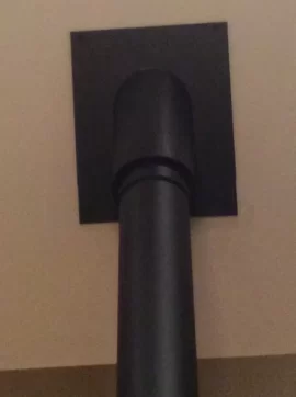

I found this picture of the class A Selkirk pipe before the connector pipe was installed. If what Webby3650 is saying—that the top can be grey areas the manufacturers don’t really address—it’s any wonder how a successful connection between the connector pipe and the class a pipe can be made. Especially since the collar/trim piece doesn’t fasten the two and there’s apparently no place on the class A pipe to screw into the connector pipe.
That’s why we shoot 3 screws through the double wall pipe and through the stovepipe adaptor. It’s rock solid then. We’ve got other ways to make a secure connection at the stovetop. We don’t just set an adaptor on there and hope for the best..

Looks like you may not have 2” of clearance there. Why did they use a roof support rather than a cathedral ceiling support box?
Reactions: moresnow
I had them cut more of the drywall to be 2” away before installing the ceiling cover. I elected not to do the CCS for aesthetic purposes (wife said “no way”)
