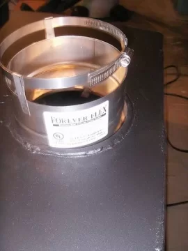

I am installing an '01 Lopi Revere fireplace insert. It has a 6" round hole in the top. I ordered 5.5" SS Forever Flex flue liner kit because I have a clay flue in my chimney that is only about 7 x 11 inches. The flue liner dealer said a 6" flex liner would never fit. I was told that the flue collar adapter would fit my 6" appliance. As you can see in the attached photo the adapter is very loose with about an 1/8" to 1/4" gap all the way around when inserted into the hole in the top of the insert. There is no way this is right. Isn't it going to leak?

So how do I seal the gap? Or can I buy a connector that will connect my 5.5" ss flex liner to my Lopi Revere ?

While it doesnt sound right, it doesnt look too bad. I would definetely get 3 sheet metal screws in there to secure it to the flue collar and then use furnace cement to seal around it or even a piece of "rope gasket" stuffed in there with a blade of a screwdriver should work.
What he said!
hmmm you have a collar. I didn't have a collar, just a hole. Mine fit in ok and then I had to put some angle braces on it to hold it in. Mine is a little older though. What the others said about just filling it... dont forget the screws though.
