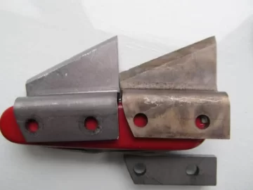

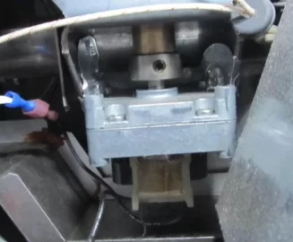

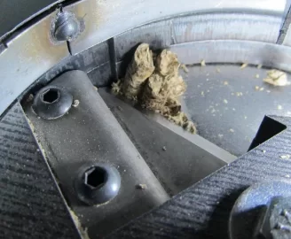

Bought Lopi AGP in Oct 2013. It was a one year old Stove that was used in Showroom and was then moved to outside used Stove area and sold as such. After much searching for information regarding this model I found that when it first went on the Market it had a Recall for underpowered Auger Motor and the need to have HRD, Horizontal Rotary Disk Shear Blade re torqued ( to what Torque I do not know ) I asked and was assured it had upgraded Motor and had been correctly torqued. Problem: After burning 3 tons of Pellets last Winter and doing by the Book cleaning before this Yrs start up, Stove would ignite run fine and then go out. I've narrowed it down to Pellets getting wedged in Rotory Shear Disk and cutting supply of Pellets to Burn Plate, resulting in loss of Fire. I was given a 6 Month Warranty and don't know if they will stand behind the fixes they say they made? As my problem seems to be associated to those recalled parts. Since I know Auger Motor runs, Auger feeds, I'm thinking needs more Torque for Shear to snap Pellets and not jam? Long Worded Post, sorry. But does anyone out there have Lopi AGP and or similar problem! Thank You, Ct Willy
