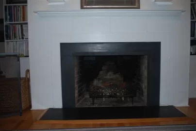

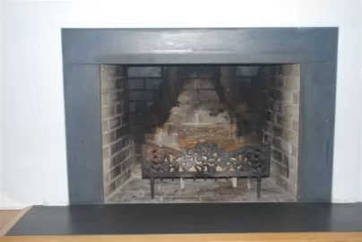

Attached are a few pictures. The size of the internal fireplace is more than adeuate to house a Jotul 550, but it is the small hearth and nearby combustable wood that is causing me problems.
Hope the photos help.

Looks pretty similar to the setup lots of us have. You can get a removable hearth pad board 18" wide and set it in front of your hearth when you are using the stove, pull it up in the off season, no biggie. You can do that even if your insert isn't flush (mine is not, the board sets in front.) Which part of the pic is the Fascia board? If it's the black part, it has to go. If it's the white, that prob doesn't stick out more than 1/2" or so? The mantel looks plenty far, but if it's not far enough, you can get a mantel shield. I have one that goes up with strong magnets to the underside of the lintel and also comes off in the off season, (I don't use the surround around the insert.) pic here is from off season, dog bed is where hearth pad goes!

That is a great solution! I thought I heard the hearth had to be one solid piece, but if I could just buy a hearth extension pad that would be perfect. I would then really consider a Regency Hampton HI300. This unit would protrude some but the hearth extension would cover that. The nice thing about the Hampton is that it only requires 33.5" of space from hearth to first combustible area in height (if that makes sense).
The fascia board (wood combustible material about 1/2") is the white portion.
Thanks again and great setup.
