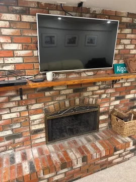

Hello. Long time member, first time poster. I've learned a lot reading this forum but I couldn't find an answer to my question.
I am hoping to install a wood burning insert into my existing open hearth fireplace (see picture below). I have read on this forum that the general consensus is if you go with the biggest stove/insert you can get, you won’t regret it later on. With that in mind, I had my eye on the Century CW2900 which is a great price right now, at $2,089 CAD. My only issue is that while perusing the literature on the Century website, I found that there is a requirement to have 84” above the bottom of the stove (see the attached picture from their manual). My current fireplace is on a raised hearth, and since it’s a basement it would only have 73” from the brick hearth to the ceiling. Overall ceiling height is 86". See the picture below.
I have no intention of ignoring the recommended clearances, since I don’t want to create a hazardous situation or cause any issues with my insurance. BUT: Am I reading this correctly? The Drolet/Century inserts are the only ones I can find that list a minimum ceiling height above the appliance in their literature (Regency, Napoleon, Lopi do not, as far as I can tell). My only alternative is to go with the Century CW2100 which has half the sized firebox and is currently more expensive than the CW2900… Is it possible this “Height above appliance” number is just a carry over from their owners manuals for their stand alone wood stoves? Thanks in advance for your advice!

The first concern is the distance to the mantel. The minimum for that is 27" above the insert top. The ceiling height is an odd one. Usually this is less of a concern with an insert. The best thing to do is to call SBI (Century) tech support and ask if this is a carry over, or if not, if a ceiling heat shield on 1" standoffs would suffice to reduce the ceiling clearance requirement.
Thanks BeGreen. Re the mantle: I had planned on moving it up to get the 27" but thanks for the reminder.
Re the ceiling height: I too wondered if maybe this was just a copy and paste from one of their free standing wood stove manuals. I will call SBI to seek clarification. If I hear anything that clears this up I will let you all know.
Cheers
I phoned SBI and the tech I spoke with confirmed that since the 84" measurement (from the bottom of the fireplace to the ceiling) was in their manual, it must be respected. So I guess I can't go with the CW2900. Does anyone know of another manufacturer of Wood inserts that can compete with the SBI inserts on price point? Thanks.
