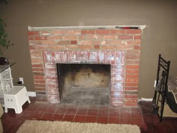

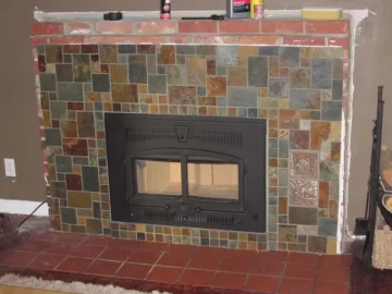

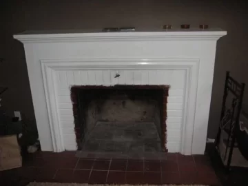

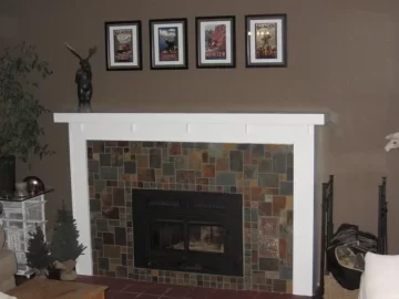

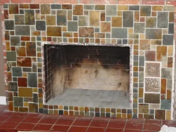

My wife and I upgraded our open fireplace this year and installed a Lopi Declaration insert. We even went so far as to build up the bottom of the old firebox before installing the Declaration. This accomplished two things, it raised the bottom of the insert off the floor (easier to load), and made our opening/surround roughly symmetrical. Obviously looks were important on this install. We also had to relocate the blower control to the front of the unit. The final result looks great! I have posted those pictures along with this post. We are very proud of the work we did, I had never attempted a big carpentry project like this and we couldn't be more pleased.

Also, Abe - your install looks great! Our house is an older cottage with craftsman elements, and the inspiration for our fireplace and mantel started with the two handmade tiles that are now on the right side of our insert. We downloaded LOTS of pictures of period fireplaces and mantels as we finalized our ideas. I ended up with what I thought was a pretty ambitious plan (especially since I hadn't ever done this sort of DIY project previously). When I discovered this website, I poured through all of the posts about the Declaration. Your insert installation ended up giving me the confidence that my idea was possible. When the insert arrived the guy from the store gave me a crazy look. It certainly was a fair amount of extra work (as opposed to just using the standard surround size) but I love how it turned out!
