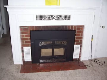

I'm very excited! :-) Here's to hoping / praying it all goes well. I got my little woodshed built and stocked with a cord of almond and a half cord of softwood. Fire ring stocked on the porch. Weather is finally starting to cool down, so I'm ready!
My main concern is that there may be an issue with clearance to the mantel, in which case the mantel will have to be raised. I'm a woodworker so I can probably do this without too much problem. I'm wondering if this is something I'll have to (or should) do myself, or if the installer will handle it. There is a heatilator vent thing in the middle of the mantel, which I assume would need some kind of sheetmetal ducting or something to move it up. Not sure how that's going to work.
Here's a pic of the current set up. Hopefully I'll be able to post "after" pics soon!

Well, here is the after-pic. (Assuming my webhost is working... acting wonky tonight):
[Hearth.com] Lopi Declaration scheduled to be installed today!
Try the attachment if this pic doesn't work. Grr.
So the black surround almost covers the vents on the side. It looks... well... stupid. :(
That's my fault, I never figured the measurements of the surround, just the measurements to be sure the thing would fit in the space.
Any ideas on how to deal with this? Do you know if you can cut those panels? I couldn't cut the top one, because it needs to cover the hole. So would it look funny do you think if I cut the two side panels about 4" or so, but not the top panel?

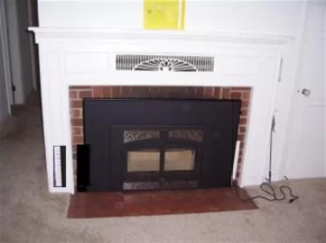

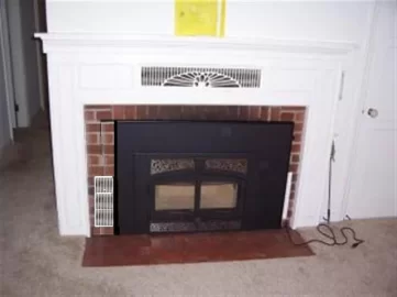

Take some white chock and draw a line on both sides 4 inch and see what it will look like. Stand back look get opinions from deferent people. Then leave the room for a while and come back take another look. Might change your mind. Look at the top panel and compare sides to top. I did a cut and copy paste on you stove to give you an idea. Call and ask the stove people if the panels can be cut. If they can use a power jig saw with metal cutting blade and straight edge clamped and go real slow. paint edge with high temp. stove paint. The first picture is after the cut. the second one is the partial vent painted black.
Wipe of the chock with damp rag, Make sure the stove is cold when doing this.

Thanks, Fake coal burner, that helps alot. I will play with photoshop some more to see what it will look like with a bigger panel also.

If you have a block off plate at the fire place dampener you would be ok. keeps heat from going up the chimney and cold air from coming in to room when not used. I only did the 4 inch because I did not know the size of the vent. If the vent is still connected might work as gravity type vent also cold air in hot air out the top vent. I think you will be ok with more cut especially if you have a brick lip left. not a black seam hole. they are for looks those panels.
If you can take the panels off of the sides. Take and make a card board templet to your size you need paint it black tape it up there. See how it looks to your liking. Better that ruining the panels if it doesn't suite you.
Well, I had them come out and trim the surround today. I think it looks way better. It doesn't maintain the rectangular shape of the stove, but that is OK. Much better than the mostly-covered vents, I think. I will probably have to raise the mantel by 3" to make proper clearances. I think it will look better then, because there will be more brick showing on top.
Now, about that power cord. The installer said they don't do hardwiring. Is there anything wrong with just running some 12/2 romex up through the floor, and in through the side where the power cord is now?
