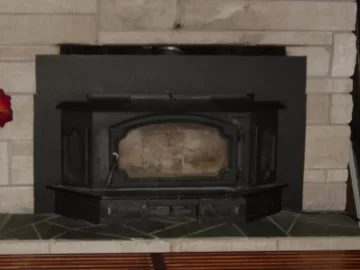

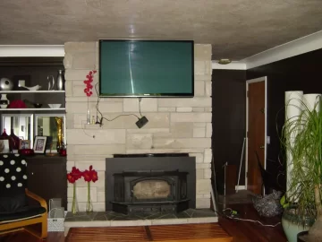

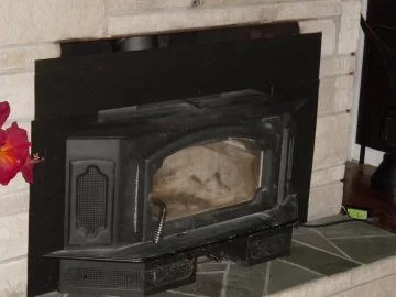

I do need a new piece of surround for the top, should that be purchased from Lopi or a local fab shop??
None of the pics came through, but I'm guessing that it has 8" panels and you need 10" panels. It would be best if you go to your local hearth store that deals Lopi.
Try sending pics again

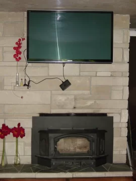

Ya, you need to get a set of 10" or maybe even 12" panels. Find a local dealer and see if they would take the 8" panels on trade. They look new, if so they might do that. While your there get a can of Metallic Black Stove Bright, give that stove a spruce up!
Another thing to keep in mind, that tv will have a significantly shorter life due to the heat from the stove. A shelf mantel will help a lot.
