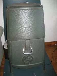

Of course we'll need some pictures. I think you are the first Leyden owner posting here so we'll all be very interested in how it works out for you. Please keep posting your impressions and observations. Also, it would help to know what part of the country you are in and what model Jotul are you replacing.

The Jotul, well, I've no idea what model. It came with the house. Its ugly, and burns hot and fast. Its a front loader. Sort of triangular, but with a flat top. It has a screen for viewing, but we rarely use it, so the door is usually shut. It looks like a big scary face with a nose ring. Very 70s. I love the new stoves. They're pretty and we can see the fire without the issue of sparks.

I am posting a picture to guess at the Jotul model. Does your stove look like this one?

That's Him! Hee hee. I wouldn't have expected he had any siblings! :)

I think that is the Jotul 4. Some folks actually liked that design. Well each to their own. I like the looks of the regular Jotuls much better too.
Well, I guess that's true. And in 1979, I'dve probably thought it was the coolest thing! But it hardly goes with the little old 2 story farmhouse - I guess a toned down Queen Anne - 2 stories, 3 Gables - built in 1908 which we use a family friendly ecclectic antiquey decor.
