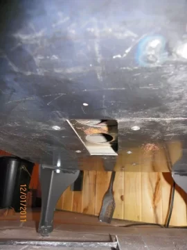

Here is what the bottom of our Liberty looks like. I will call our dealer tomorrow to see if I can cover that.

To find out what will happen, just slap a piece of heavy aluminum foil over that while it is burning. Make it big enough that it doesn't get sucked in.
I'm not sure why they took out the knock out plate but will see if they have something else we can try. We are not having problems but sit here wondering if I would get longer burn times if I covered it.
Burn times loading N/S have been between 8-9 hours with cherry splits on the bottom with sugar maple on top, about four cherry and four sugar maple splits.
zap
Ya that's it.I partially covered the opening with heat tape to good results along with the pipe damper.
