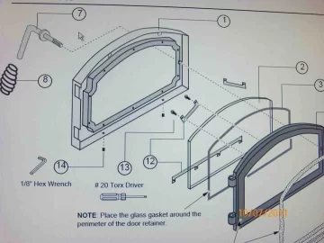

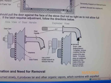

This is our third year with the Liberty. I burn down the coals below 300 hundred before reloading, this should help with the stove top temps. I also made the seal around the door tighter by taking off one washer (in the manual) so our control of the wood stove is much better.
Door issues; on page 27 of your manual it will show a picture of the door shell, make sure it is tight because the set screws on the bottom come loose (number 14 o the same page) that will give the door shell a loose feeling.

Here are some pictures of the set screws I mention in my first post, also the washer you can take off if you need to tighten the seal.
