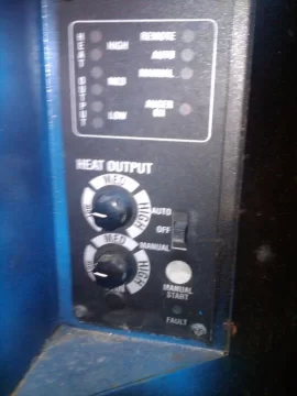

I am in the process of rebuilding a Lopi Pioneer PS (Heritage Bay PS). It has the older control panel with the 2 knobs for feed rate and fan speed.

I am amazed it is that old! The only difference on a new one is the control panel!
All the components seem to work.
The combustion fan is vibrating and the screws on the shock mount were loose. When I tightened those screws the fan blades started scraping the exhuast plenum when starting up. It still vibrates too unless I put my hand on it, then it stops.
How should this be fixed?

This is the 1st rebuild for me for a friend that dropped it off! Wow it is a win win situation! This stove was DOA but built like a tank! It was beat up and left on an outside porch! However it is one of the best stoves I have seen to resuscitate! As you can see on the control panel it can be used in Auto-On/Off mode on a T-Stat and has nice knobs to control heat and fan settings. The settings are displayed with LED lights! The brand new Pioneer stove sold today is no different except the all digital control panel. The stove new sells for $2,902.00 !!! see > http://www.hearthsidedistributors.com/s.nl/it.A/id.49537/.f
