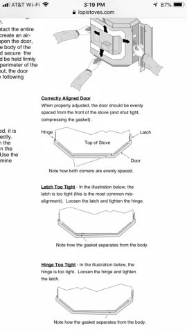

Well with the clear vent and everything else you have done, I must admit it's quite the quandary. Only thing I see is the glass seal and door alignment in your manual. Other than that I would have to start looking for cracks in the seams of the fire box itself.

I would check the alignment just to rule it out.

I also rechecked the door and it was slightly tight on the latch side. It was passing the paper test, but not in perfect alignment.
I put everything back together and the difference was literally night and day. Flame looks like it used to, small embers and fly ash are being blown from the pot.
