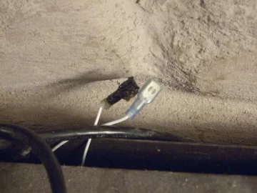

At the end of last season we got to the point that the blower would not turn off, even when the stove was dead cold. I touched the back of the snap disk and almost blistered my finger. Preparing for this season I have removed the disk, in hopes of replacing it. I found out what the problem was...
Both of the contacts were loose on the switch body. One was so loose that it caused overheating and the plastic on the spade connector was melted down and charred. I know who the manufacturer of the part was, and I can see why they have discontinued it. I guess I'm just lucky that there wasn't a fire.

CTC is as it is supposed to be. The stove, itself, is in an alcove lined with adobe. I have attached a photo to show what the problem is. Those female spade connectors used to connect to the snap disk. Note that one is the way it's supposed to be and the other is carbonized. How much hotter did it need to get to actually flame?
All the electrics are properly grounded.

Heck I have seen that type of damage on those types of connectors having nothing to do with wood stoves. A poor contact will cause an overheat problem at the connector resulting in a higher than normal current draw leading to what you have. If it was from stove heat both would be fried. Snap disc switches are notorious for internal break down ,contacts get pitted by arcing causing the high current draw.
This can also happen if the connector is not fully slid onto the spade of the switch.
