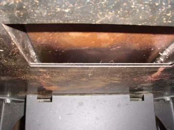

Where exactly are you talking about Sticking aluminum foil
If you look up under the stove there's a rectangle shaped hole I'm guessing this is where the OAK would go if you had one). There is a gap in the front and another in the back, that's where we stuffed the foil and it seemed to slow it down fairly quick.
Stepping back now. As I always admonish people to do I am gonna leave it with somebody burning the same stove to get ya dialed in.

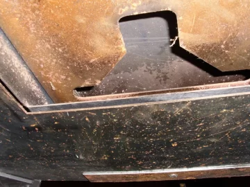

here are pics I took just after I installed the stove one is part way closed, one all open
[Hearth.com] Lopi  Republic trying to take off to the moon?? [Hearth.com] Lopi  Republic trying to take off to the moon??

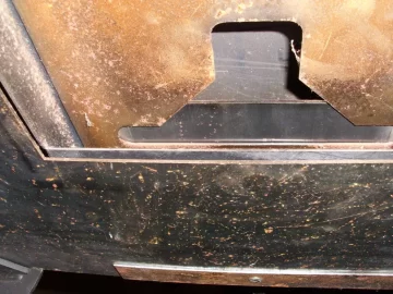

Ok this I just took of the back of the rectangle

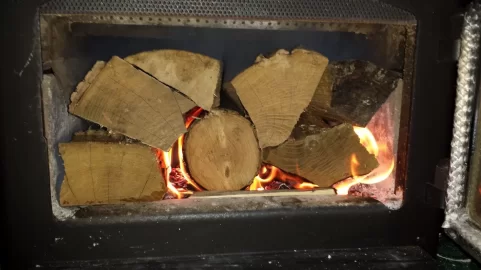

Yeah people get convinced that they have to do that with a non-cat. It just ain't so. Build a nice fire in your wood stove and stay warm. Let those tubes up top do what they were designed to do. Pick off stray gases that escape the fire below.
I have the full night load settled after 30 minutes and there ain't a "secondary" in sight after the top splits charred. Just flames.

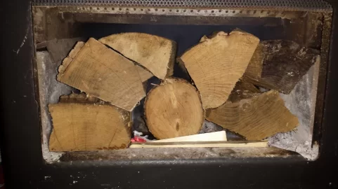

,Pulled the coals forward, Loaded it up with just ash And eased up on it, instead of blasting off, That worked pretty good, It is still cruising at 680.
I think maybe the oak is causing some problems Because it has an inch or so of dry punk on the outside
