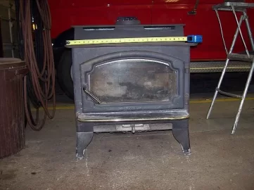

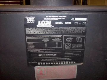

Hi all I am new to this and i hope you can help me learn a thing or two.
I am looking at a Lopi 520/96 stove the guy selling it has sent me photos that I have attached he also told me that it is a 1996 stove and is needs a glass gasket (I think he means door gasket) and paint. Not being familiar with the stove I asked him if it had secondary burn tubes? He replied that it had them but they only lasted a year before they fell down and got in the way of putting wood in.
my question is how long do these tubes normally last? Should I be worried that the stove was often over fired? Or is this common for Lopi stoves? Any information is appreciated
