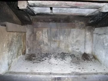

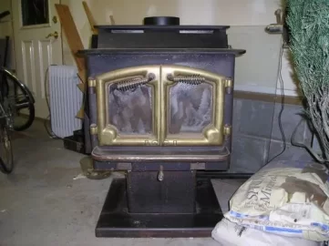

I have looked at the stove it is a model 380/440. The guy says it is around 15 years old but not used that much. He claims it is a high effeciency but it does not have the "reburn" tubes in the top. He wants $800 for it. I am attaching photos. Would I be better off buying this or a new Napolean 1100PL for $1250?

I think you can do better than that for $800. Check out the Englanders, alot of people here have them and love 'em. If you post some specifics on your needs and your home, I'm sure you'll get plenty of good info from actual use, which helps!
It's an OK looking old stove for a wood eating smoke dragon. Too bad it's not a 520...precursor to the modern stoves. But even then, you'd have the problem of dealing with an 8" flue collar. For his price, I'd definitely pass on this old stove. You can get yourself a brand new, EPA approved, efficient woodburner for little more than that. Rick
Ditto. It's a "more efficiency", not a "high efficiency" stove. You could do worse, but you can do much, much better for that much money.
