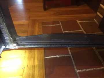

So, here's how the door looked. I managed to remove it last night. Being a model "B" Santa Fe, I used a phillips, not an Alan wrench to get take it off.

The tadpole gasket should of came with some high temp tape, to tape the ends so they don't frey. You should be able to see how the gasket is on your door now and duplicate it. And you should be able to google a utube video on how to install gasket. And I don't understand your Philip/ allen statement as door just lifts off. I would use the tape and not the red caulk as it takes a long time to dry and will not do as good a job. kap

Hello, just a long overdue follow up. I installed the tadpole gasket myself. I did a somewhat bad job of it but we managed to continue to use the stove until this past spring.
Here's a few things as a total newbie that I learned and are of my opinion only of course.
1. wear a mask.
2. the thermal tape for the frayed gasket ends on this thing is expensive. You get about 1/2" of it with your order, it's expensive and it's not very forgiving with any mistakes.
3. I gently tapped (using a hammer) a flat headed screwdriver down on the two metal poles (that you initially pop out to remove the glass.) That was the only way i could get them back in. It was like I was stuffing the gasket in.
4. I misjudged how much adhesive tadpole gasket I would need to wrap around and had to remove and redo it. It got all bunched up in the corners when I tried reinserting the glass. (see above) The corners are STUFFED in there but I'm learning, right?
(see pics)
5. the gasket replacement "worked" with my DIY install but the bottom corners of the glass would get black pretty quick after a few cycles. The stove itself is over a decade old and basically sputtered and wouldn't stay lit but that was months after my work on it.
The pics of my work are below but just wanted to share what I learned and thank you guys.
