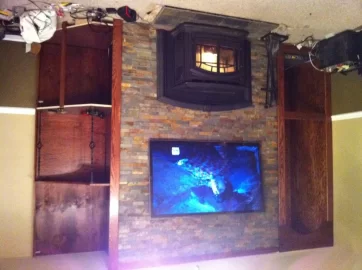

The addition of the M55 has led to a whole room renovation.
Pulled out the original fireplace insert (tired of splitting wood and daily clean out).
Added a stone surround, repainted last weekend, bought a new HD TV, and now am building in wall cabinets.
Next month will be hardwood floors, costa rica teak.
Will never want to leave the room then.
