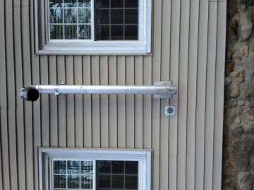

Post a picture of the termination outside the house. Maybe someone will pick up on the issue causing the high pressure.
OAK screen too small a mesh, wind guard closed too much, OAK termination to close to the vent termination, out of round tubing, too long a OAK run (works just like any other vent system), OAK on the inside of the air intake when it should be on the outside (depends upon stove design), crud on the OAK screen., and OAK termination above the vent termination are all things to check.
I'll take pictures tomarrow.

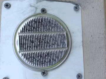

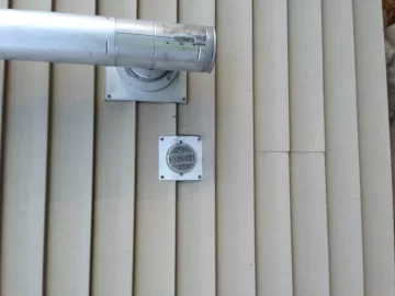

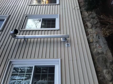

Ok here's the pics

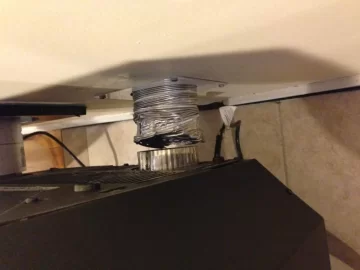

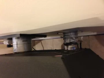

And this what the guy did and my stove is running better. He moved the oak off so now it's not attached.

I am assuming the AOK is too restrictive. To test it you could hook the magnihelic up and place your hand over the stoves inlet. I bet the numbers spike like when you have the hose hooked to it.
If so you might want to ditch the cap on the OAK and try something else.
Reactions: SwineFlue
That's what I was thinking. Do I need the oak? I mean the stove is running good and my mag numbers are ideal
That depends if you feel drafts. Right now its still suckin some of the air being pulled in from the OAK. If you remove the hose and cover the opening in the wall. You may start noticing drafts(windows-doors-ect.). I would then look for a less restrictive OAK.
That's what I thought....the outside air inlet grate looks too restrictive.
I'll replace it. Funny thing I googled pellet stove OAK and that came up from the distributer where my dealer gets his stoves from. Russo in SouthEastern Mass.
Id put a 90* elbow facing down on that with some hardware cloth fastened to it. Baud a Boom Baud a Bing! Oh yeh and make sure its high enough that snow drifts dont bury it or you will get chilly.
I just used a dryer vent hood, removed the flapper, and ran some aluminum flex tubing to the stove. less the 15 dollars and works like a charm!
