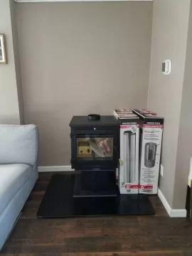

I had my Madison Smart stove installed for 2 weeks now. The stove works well but is creating a whole lot of dust that I assume is from the ash. It does have a blower instaled that we use. Could the blower be blowing the ash around that is in the ash bin at the bottom of the stove? Any help or suggestions would be appreciated. Thanks!
Shouldn't happen. Do you have the blower off when cleaning ash in the stove?
Yes the stove is completely off when cleaning out the ash. No fire and no fan. There is a intake hole in the back of the stove that I believe goes directly into the ash box. I thought maybe some dust may be coming out though there. From now on I'm not leaving any ash in the ash box at all to see if that will be better.
