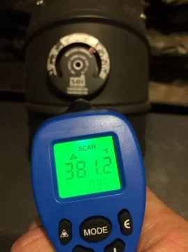

I bought a IR thermometer yesterday. My magnetic thermometer on the stove says it’s 500F and the IR says it’s 381F that’s a big difference in temperature
Magnetic thermometers are not terribly accurate but cheap ir thermometers are not either.
Reactions: ckr74 and Nate R
The Ir gun was on sale at Canadian Tire for 20 bucks regularly a 100 bucks so not that cheap just seem weird that’s it’s like a 115 Degrees off I could see 20 or 50 being more acceptable
Disappointing for sure. Did you try all around the magnetic to see? You are reading the pipe around it with the IR right? Not the magnetic thermometer itself?
Do you have any other thermometers/references you can compare to?
Yea I was reading all around the thermometer with the IR gun not the thermometer itself and no I don’t have any thermometers to compare it to I’m gjnna head over to my fathers later on and measure his pipe around his thermometer and see what that says cause either my IR gun is messed up or my magnetic one is something isn’t adding up lol. on the plus side apparently I’ve been running my stove on the cooler side and it’s been cooking us out of the house so I known she will definitely pump the heat out in the cold weather. I’ll be checking my chimney this week for creasote as I’ve clearly been burning the stove a little cool.

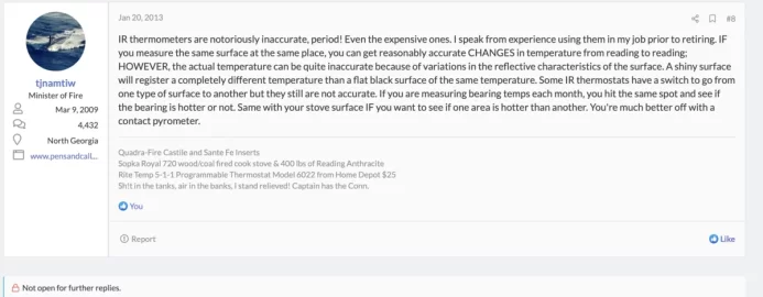

Huh. Further research in the archives here produced this:

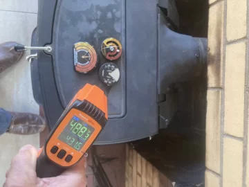

What gives? As you can see from my original pic, all three magnets disagree, but the Thermpro IR agree with the Rutland. Who to trust?
[Hearth.com] Magnetic thermometer way off
User "tjnamtiw" seems to not be here anymore, but makes reference to certain material types giving spurious readings. The instruction booklet for this IR gun refers to this as the "emissivity" of the material type being measured. I had to call the manufacturer to get a clear understanding of this, but essentially the IR gun I bought can be set to the emmissivity rate of different types. I wish I had done this step before posting my first picture because the IR gun now strongly disagrees with the Rutland and is much closer to the Chimgard & Galafire.
[Hearth.com] Magnetic thermometer way off [Hearth.com] Magnetic thermometer way off
LOL. The Rutland is not way off. My guess is that if a temperature reading is done on other spots close to it, maybe to the left of it, that it could be close. The Condar is a flue thermometer. If the stovepipe is single-wall, try placing it about 18" above the stove and see how it reads there in comparison to the IR reading.

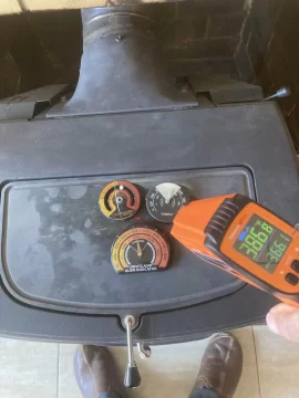

Here is what I get on our 32 yr old. SandHill thermometer. They don't make them like they used to.

The griddle isn't painted, is it? I did play with that idea and take measurements from griddle surface and then 1/2" away on rough cast surface. There was a slight difference.
And begreen - the flue thermometer has different markings for what is considered "cool" and "overfire", but still is just measuring temp, right. And it is a hearth install, just a short steel collar connecting the flexible insulated liner to the cast collar of the stove. Can't get flue temp.
The spot where the red dot of the laser is pointed looks much blacker in the first picture. What readings show up if it's set to .95 and read off the painted parts of the stove? How does this compare with the thermometers placed there?
