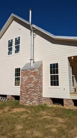

I'm very new to this forum, and to wood burning stoves , but I try to find answers to my questions before posting. I live in Louisiana so we don't get the harsh winters seen elsewhere, but it still gets into the 20's and 30's, and when you add humidity, it seeps into your bones. Anyway, I have a new construction farm house and we opted for the VC Encore 2040 as being both more utilitarian and "farmhousy". I wanted to run things by this group to get your opinions.
I recently did my three initial burns, getting the stove up to 200, 400, 650 degrees respectively using a stovetop thermometer, before closing the air intake and letting her burn down. My flu gauge seemed to follow suit as expected with its temps up to about 400. CAT levels were lower, but of course I had the bypass open during these burn-ins, and left the air intake wide-open. I also opened the bottom ashtray to get the fire going initially and up to temperature, but have since read not to do that b/c of overfiring concerns. My flu pipe is 6" diameter, 2' of single wall inside, before converting to double wall and exiting the house vertically (see pics). Total height from stove top to chimeny cap is approximately 20'.
SO onto the maiden voyage. I'm using split pecan wood with MR around 15-20%. Temp outside are 29-45 degrees today, breezy. I seem to have a very good draft, in fact when I lit a little new paper at the base of the flue pipe (inside the stove), it burned a few seconds and then got sucked up flu pipe. It wasn't a lot of paper, and there's no cresote up there because everything is brand new. I'm not sure if that means there's too much draft? I did a top down, E/W wood stack (about half the box if full), this time cracking open the front loading door for 10-20 mins to get the fire going instead of the ash tray. At about 400 degrees, I closed the door, but left the air intake wide open. When the stove reached about 550 degrees I lowered the air intake a bit to get it down to 500. During this time, my flu pipe thermometer was lagging behind at around 150-200 for some reason, so I opened air intake 100% again.
At this point, I closed the bypass to engage the CAT for the first time ever. It's been running about an hour now. My stovetop was a bit over 500, and is slowly comign down. Flu still not getting much past 150. The CAT temp went up to about 550 upon initial bypass engagement, stalled, and is slowly dropping- currently at 496. I see active flames and can hear a slight "whisper" which I assume is the air intake. I'm getting moderate amounts of white smoke comign out the chimney cap. So it seems like the stove is not holding its heat, and that the CAT is not active. I thought maybe i put the CAT probe in too far (AT 100) and was getting in accurate temperatures, but the white smoke is another tell.
Are there any thoughts on my overall setup, or obvious reasons as to why my temps are dropping and CAT didn't activate? I'm going to add more wood and see if that helps.. which now seems kind of obvious. :) Thanks!

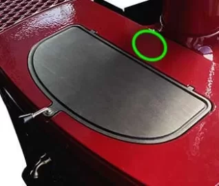

A very helpful tip my VC dealer gave me was to place the stovetop thermometer centered between the rear of the cast iron griddle/lid and the front of the flue which is in contradiction to the placement specified in the manual. The reason I was given for this change of placement is the temperature usually is higher there and also is usually more indicative of the general heat within the main body of the stove as the cast iron is considerably thicker there than compared to the griddle/lid.
