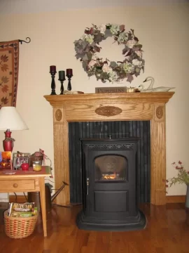

Here's a pic of my stove [Hearth.com] maintenance advice for me? Thank you!
Nice unit Will.....
Welcome Courtney. Santa Fe is a solid unit and should last a long time.

Welcome to the Forum, and pics are always welcome (pics of your set-up)??
