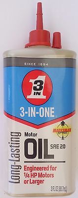

This is not a job for anti-seize. Anti-seize is an assembly lubricant, not meant for rotating or sliding assemblies. I would think some type of high temp graphite lubricant would work well.
Reactions: monkfarm
Agreed.
This works fine for lubing small fan motors.
