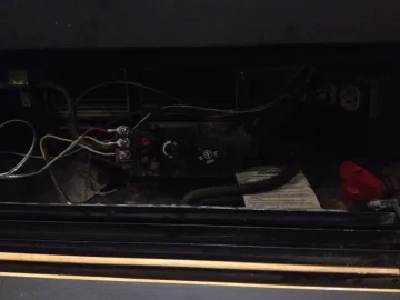

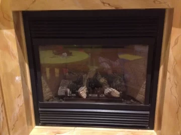

Can you post a picture of the front of the unit & also a close-up of the gas valve?

I did some research and believe the model # is 33BDVR; see photos attached.

Unless you can measure the gas pressure with a monometer, you can try clearing the gas lines by bleeding them where they enter the valve.
You can also try to adjust the pilot flame. I can see the screw on your valve in the pic. It's brass & it's located below & to the leftt of the HI-LO regulator.
You will need a multimeter to read the thermopile when you adjust. Shoot for 550 mV.
If you can get the pilot to hold, & the burner still doesn't light, you may have to remove the burner & check behind the burner orifice for a spider's nest.
EDIT: Looking at the picture the red knob on the gas line looks to be in the off position...

Viola the fireplace lits on now! After cleaned the pilot with air compressor the pilot lit bigger and stable. Also found out the thermostat is bad too after bypass it by jam the 2 points. Thank you much for all your help!
