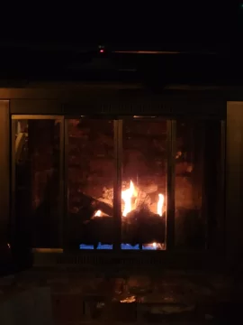

Sorry, let me attach some pics. I'm testing on these wires that go to a thermostat thing that plugs into a wall outlet. It just has one button in the wall outlet which seems to provide some sort of mV? I'm not using that though for any of these tests. I'm just turning this dial to ON here on the log unit

Yep. When the knob is on ON I can then switch the rocker to ON and the flame lights
So I'd guess that switch is in parallel with the control wires so it shorts them together when it's on. That's why the voltage drops down to zero. Still doesn't explain your low gas flow issue

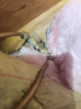

Here's what is in the crawlspace on the underside of what I turn the key, one side goes outside, other side goes to fireplace unit. Doesn't seem like a regulator? But not sure

Would the key turning valve include a regulator by chance in that unit?
Not likely, I was just trying to think of possibilities. That valve is just a gas stop and should give a 1/4 turn between open and closed.
Usually, for a 100lb tank you would see the regulator at the tank. But it's possible they had like a 2 psi system and there was a secondary regulator at the gas logs to drop it to 1/2 psi? But you'd probably be able to see it if that were the case.

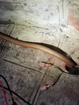

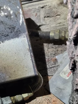

This is where it comes out from the crawlspace and here's a changeover it does into the unit. That's about all the difference I can see from the outside

Yeah I dunno, this is where the manometer would come in handy to see if you're getting the right pressure at the valve. But take a step back is there any way you can get a reading of the actual thermopile voltage with the valve on? Not the thermostat wires. A weak thermopile could cause this issue also and I don't believe we've ruled that out.
