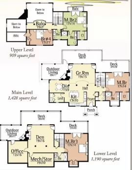

EDIT: After more reading of other posts, I felt it would be helpful to include the floor plan:
(attached in post below)
We will not be including the two fireplaces on the lower level but will likely keep the outdoor fireplace on the main floor. Any suggestions on the best way to move heat around the house would also be greatly appreciated!

Can you post the floorplan directly to the website? Only the upper floor is showing.
Thanks for the reply! I've been reading non-stop since my first post and certainly know more now than I did then. I've added each of the ZCs you recommended to my list along with the EX90 and the FP30. I'm also now realizing that choosing the ZC is only half the battle. Determining the best way to move the heat around the house seems to also be a challenge. I attached the floor plan.

It's a pretty open floorplan, but with the wide open ceiling to from the great room to the upper floor I think a lot of heat is going to head right upstairs. For sure you will want one or two ceiling fans there to help break up heat stratification. Or skip the balcony and put a bit media/playroom in that space. :cool:
Some fireplaces have ductable heat output that possibly could be ducted over to the kitchen or bedroom
I did notice that the FP30 has two optional remote heat duct attachments. However, the maximum run is 20 feet which would make it impossible to reach the master bedroom. I also see that you can only run horizontal or upward which would also make it difficult to reach the kitchen. If the outdoor fireplace doesn't interfere, I suppose one remote heat duct could go to the wall in the dining room if that would be beneficial.
I made a note regarding the ceiling fans. Thanks! If I manage to generate enough heat for the main and upper levels, I suppose I would need my primary heat source to be designed such that it can be turned on only in the basement.
Yes the primary heat source should be zoned with separate thermostats for the lower and main levels.
The Quad 7100 has a provision for blower intake air that can be ducted as a return duct. That could run to the kitchen or MBR. As it pulled cooler air from the return grille warm air would replace it.
