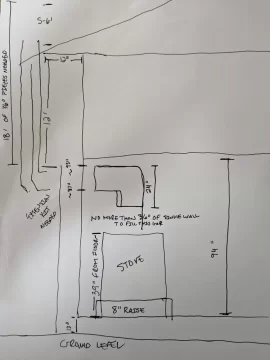

I don't want to brag or anything, but here's my simple rendering. Does this help? Am I up a creek without a paddle?
View attachment 312743how far is the stove going to be from combustibles? How far will the pipe be from walls and the ceiling?

You tell me. Flexible at this point. My understanding is the distances are determined by double wall v single wall. If double wall, I understand 6" and 8", respectively. @coaly said I need 18" for single wall.
Well the stove needs 36" inless you do an nfpa ventilated wall shield. Single wall needs 18". Double wall needs what is specified by the manufacturer

Good to know. I'm flexible with the space. I need to understand if I can do this, and preferably with 6" double wall on the exterior.
I wouldn't use 6. Lots of people use it and get away with it. But I have also been called out on quite a few that didn't work. I think they work best on 7" honestly
